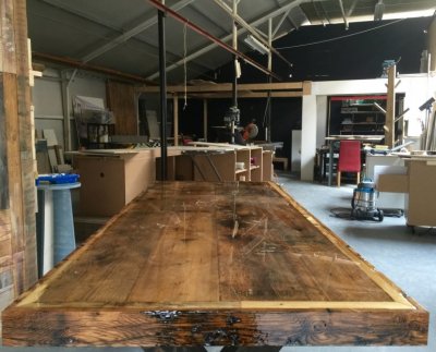

hello
here is my last project with epoxy,itis good stuff
    99,2 KB · Weergaven: 134
