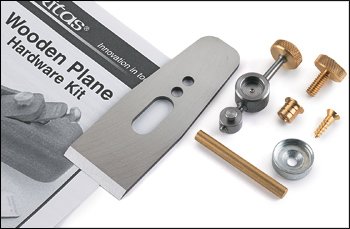

Toch maar gevraagd bij Lee Valley over een houten schaaf. Natuurlijk kent Rob Lee zijn catalogus beter dan ik.
Could it be possible to add a frog holder insert for wooden plane bodies to the LV line up (or simply have a frog shaped insert)? This would allow to use blades and setting mechanisms also on wooden planes. There nothing wrong with a self made Krenov style plane, but having more options for wooden planes may be better.
Hi Damien -
Yes - take a look at transitionals for that. Norris also did it with the adjuster mechanism - but no frog. (we have taken the same approach with our kit (soon to be plural).
The other thing to consider - frogs are not what many people think they are... in steel planes, they should NOT be a bedding surface - the blade should make contact at mouth - and at the top of the frog somewhere... not the entire surface. In fact - frogs are often machined to ensure there is no unintended contact outside of those areas. Think of a three legged stool - no rocking. A metal plane uses a line of contact along the mouth, and a point of contact farther up the blade.
Cheers -
Rob
(probably overgeneralized that a bit.....)
En ja na wat zoeken hebben ze al een setje
