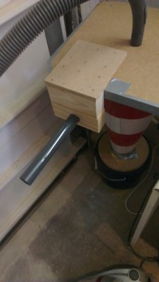

I have made myself a small dust collection system
for a portable Bosch table saw. The vacuum (small 1300W home vacuum) is connected
directly to the collection system and than from there I go to the table saw using a 3 meter
flexible pipe I bought a karwei which looks very similar to a normal vacuum pipe.
It all works great except that this pipe, makes a very loud noise like a wissel, it is so loud that I bearly hear the table saw.
Note: This is a little hobby and I don't need a big container
the pipe in the image was a test, now I have the same material but longer.
Do you think this because of the type of pipe I bought?

Is the hose from the vacuum lower in the cone then where the pipe of the tablesaw goes in.
I can't see it well but is the pipe from the tablesaw in the middle of the cone ? This pipe should be more to the side of the cone, like
the dust deputy cyclon

Phew, that's a big question. Such noises are - I think - the result of turbulence and that is notoriously difficult to predict and as a result a problem that is very hard to adress. My approach would be to take out or replace components of the system (one hose etc at a time) in order to find out what causes the noise. I agree with woodworkpro that the inlet appears to be insufficiently offset and in line with the perimeter of the cylindrical top of the cone. Bill Pentz has some very useful drawings on his site.

I will try to address oll the replies, I also have some images to show.
From what I can test the issue is in the hose I bought, if I remove it, like in the first image, there is no strange sound.
As soon as I add the hose back, a short part or a long one, I get the very loud noise again,
I have also sealed the hose to the inlet, with no change at all.
***As for the position of the inlet, it's difficult to make a decent image, however it is positioned on the side of the cone,
in fact it was really difficult to perforate the cone in that area since not being in the center. but once again, it does sound OK withour the extension hose.
Here is just with the vacuum inlet, and works perfect, there is suction and no noise

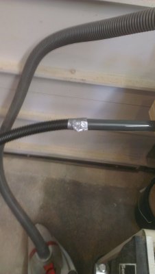

Here is with a small section of the hose as a test, and the noise started.
Here I have sealed the connection, but the noise did not change at all

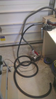

and here I replace the short test hose with a much longer one, I still have good suction
but the noise is still there. I also checked the hose for holes, but could not find any
