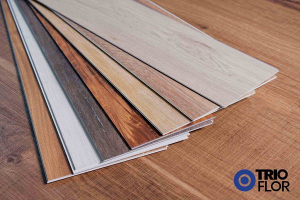

It is often said that SPC floors have high requirements on the construction ground, so what aspects should we pay attention to? Today, I will give you a detailed explanation of the installation requirements of SPC flooring.
1. The construction of the spc floor has higher requirements on the base, and the quality of the ground affects the construction effect and performance of the Trioflor SPC flooring.
2. Since it is a non-natural material, it has high requirements for the base floor. When the SPC flooring is laid, the base layer must be flat, solid and dry (the flatness requirement is to use a two-meter ruler and a wedge-shaped feeler gauge to measure the deviation within 3mm);
3. Basic requirements for the ground: There should be no sand formation on the surface of the cement floor.
Ground hardness: The volume ratio of cement and mortar for the leveling layer should be less than 1:3. It is required to use Dachang cement, the strength grade of cement concrete should not be less than C20, and the surface hardness should not be less than 2Mpa. Test the surface hardness Use a sharp sledgehammer to quickly cut and file the ground without marks or grooves.
4. The surface of the plastic floor is smooth, the yin and yang corners are square, there is no falling edge, and there is no oil, dust and impurities.
The smoothness of the ground surface: the surface of the ground foundation should be smooth and flat, and it is required to "smooth and finish the surface" (that is, use the plasterer's iron trowel and other mortar layers to collect and polish when the mortar layer is still dry.)
5. Ground cracks: If there is a crack in the foundation settlement, the crack should not exceed the width of 1.0mm.
Ground compactness: The ground surface should not be too rough, there should not be too many pores, and there should be no holes and potholes. The ground surface should be smooth and clean.
6. Surface humidity: The moisture content of the ground foundation is less than 8%, and the surface should be kept dry before construction.
Ground level: The height of the bottom edge of the door from the ground will not affect the opening of the door because it is laid on the floor.
No cross-construction: There should be no cross-construction during the self-leveling construction and the SPC flooring pasting period, and any other types of work should be guaranteed not to cause damage to the self-leveling and the spc floor. It is better to do a layer of self-leveling to make the pavement more beautiful, and maintenance is also required in daily life.
After the assembly is completed, the floor is flat and there is no gap. If the floor is uneven or there is a gap, you need to gently lift the floor to an angle of 10-30° to lock it, and the floor will automatically level after it is fastened.
