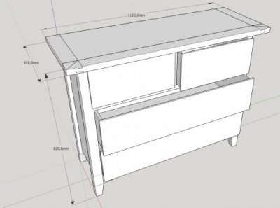

Thanks a lot guys, here is a little update after yesterday.
My parents back in Italy, have most of their forniture hand made by local woodworkers in mahoni, I always liked that wood hence that is what I am looking for.
Yesterday after posting this, I went to visit a lumber yard (will not mention the name)
The price per cubic meter of rough (not planed) mahoni was similar to what has been suggested here above, about 2000 per cubic meter including BTW
I than asked the price of a planned piece of the same wood (Mahoni Sipo) with the following measures that they had on the shelf:
D:2 cm
B:21 cm
L: 1,85 m
the price asked was 25 euros. This is when I think I left the lumberyard crying :)
I know wood is expensive but for what I just designed, it's is going to cost me a fortune and I am wondering if I need to re-think it.
I add here what I like to make, it will have few adjustments but this is the basic idea.
D:2 cm
B:21 cm
L: 1,85 m
Bekijk bijlage 35921
I also think that wood here in Holland is very expensive, especially hardwood and tropical hardwood.
There are two reasons for it I think; Holland is a small country so a lot of wood has to be imported and prices on the world market has risen very much the last 10 years because of a higher demand.
I hope you find what you need for a reasonable price or maybe otherwise you can build it with mdf and veneer .

@Ernest: I'm sure you know how to calculate the price of the timber you are buying, however the formulae as you wrote them makes the brain of a theoretical physicist itch a bit :) I'm sure however I made the rooky mistake of calculating everything too.. Ah well..
@Gepetto: About the price of planed wood: This is why I decided to buy unplaned and then try to do it myself.. In most big cities there are workshops that you can use for a couple €€, just make sure they have the equipment. The ad on marktplaats doesn't tell if BTW is included, without it's €1500/m^3, but including tax you again pay €1800+, and that isn't planed as well..
What I heard is that planing is not too difficult, when the boards are not very long. Judging by the dimensions in your drawing the longest is roughly a meter.. Should be fine **as I have heard, haven't done it myself yet**

What can I say..... solid wood, is more expensive than compressed fibreboard and fineer and as such, forget about the price levels you see at Ikea and sorts.
However. Making your first piece of furniture, from solid wood, successfully is pretty much priceless and potentially an heirloom :)
Consider combining fineer or less expensive wood on the internal and solid wood fronts to keep the cost low but still look the part.....
