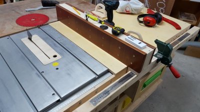

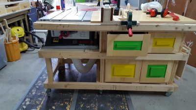

Dank u, ik zal schrijven in het Engels, omdat Google Translate do het niet good.
First I understand that moving from the Bosch to Harvey is a huge step and that there are other machines, as suggested in the middle,
I have been working for 3 years with this machine and I like to make furniture, not to sell, just as an hobby, but I like the machine to be precise.
I aligned the Bosch so many times that I just has enough now.
From the images below you can see that I have totally modified it, the fence system which is still not precise is much better than the original one.
The question I had about the money is not because I don't want to pay, I am OK to pay that price, but I don't know the dutch market
and that was the first site I found with semi professional machines, maybe you know other re-sellers that have better price for similar machines.
I will not go back to a contractor saw, I will get a full stand alone machine.
Many Thanks
